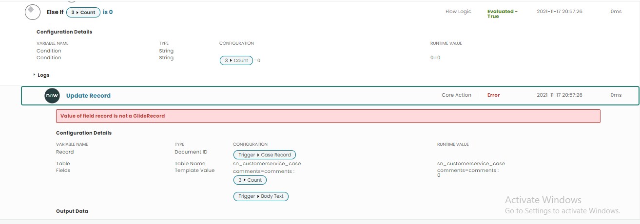

script working successfully, but getting Error like "Value of field record is not a GlideRecord"
You need to look up the record first, as even though the name of the data pill is "Record", in reality it is not a GlideRecord - just as the error states. The log also shows it to be a document_id. But you can use Record and Table as the sys_id and table name in the lookup activity.
Hi Janos,
What are the things i need to modify here
2nd screenshot
You need to place a Look up Records activity in front of the Update Case Record one.
You need to add a loop (forEach) after the Look up Records activity.
You need to move the Update Record activity inside the loop (forEach) and make it update the currently looped record.
Turn the Update Case Record activity into something like this:
I use task, cause I have no Case table in my PDI.
