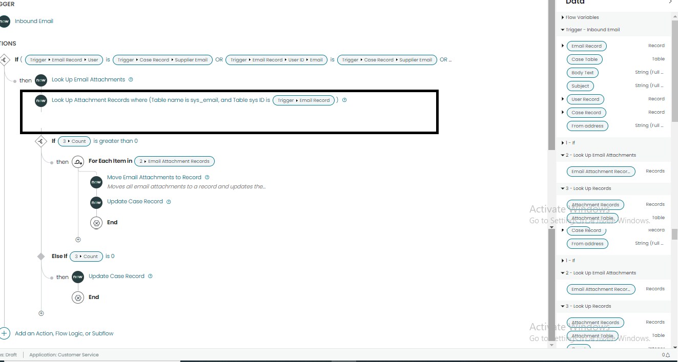

How to check replied email has attachments Or Not in Flow designer.

As an alternative, this could also be done with the help of an Action that can be used elsewhere too. I created a new Action, called it "Get Records Count"
Have defined a single input:
Next I have added a Script step that also has an input that looks the same as the Action input:
The code is pretty str8 fwd:
  if (inputs.records && inputs.records.isValidRecord)
    outputs.count = inputs.records.getRowCount();
  else
    outputs.count = 0;
})(inputs, outputs);
And - of course - as visible in the picture, the Script Step also has an output, I named it count.
Finally the Action itself also has an output, again named the same as the Script step output:
And I have configured the Action to use the Script step's output as the Action's output value:
Once this is done and activated, I can use it as below:
find_real_file.pngOf course this will result in the Count data pill that I can use to check whether any attachments have been received:

Janos Proposed 2-solution on this.
Solution 1: script
  else
    outputs.count = 0;
Solution 2 : Add " Look up records"
Result Of Solution 2
same way if we go with solution one just Need to replace of "Look up records"  with Script Event
