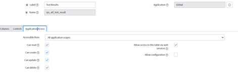

I have modified the Application Access setup for the table sys_atf_test_result but I still get the error.
