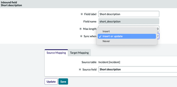

Please ensure the inbound "Sync when" field is set to "Insert & Update" for the consumer on the Remote Task Definition. Since they are initiating the connection, "Insert" will only apply to the Case on the Provider, and the "Never" setting does not copy the data to the parent fields. In all cases, you should see a worknote on the parent records for any inbound field changes.

We have made the remote task definition mappings correctly.
We also noticed there is warning shown on consumer replication set - "The consumer instance does not recognize the replication columns from the associated IDR schema". PFA the screen-shot for reference.

These warning messages are fine. They are always there when using discrete mappings in IDR, which SB uses. In any case IDRs job is complete as you have said the data made it from the Provider's Case to the customer's Remote Task.
Is there a worknote on the customer's incident with the new data for the field?
Are there any errors in the logs at the time of the update?
Please attach an image of the remote task definition form and the inbound field's form.
