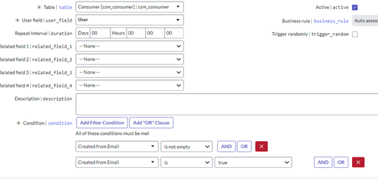

Hi SN Community,
I have an issue regarding trigger conditions not creating assessment instances. I have a requirement to trigger a survey whenever a consumer is created when they send an initial email to our instance mailbox. I am aware that the User Field only works for those fields referencing the sys_user table, hence that is why I put the referenced User field in the consumer record as the value. I tried testing the configuration with a record that fulfills the condition but it fails to create an assessment instance. Any thoughts? Thanks.
Dale

Hello @dalejaurigue11 ,
As I can see from screenshot, the repeat interval is empty, Just for the testing try to put atleast 1min time interval. And try triggering condition?
Also on a trigger condition, you will find a auto assessment business rule, So open the same BR and try adding gs.info() to make sure BR triggering.

Hi Siddesh,
Thank you for responding, I tried doing the steps you suggested and I had no luck. It seems that the BR is not getting triggered since the logs are not generated. Could this be a User field issue? I checked the user field and there is a referenced record.
I think the user field is correct, just make sure their is a user record present in the record were you trying to trigger.
And just for testing try removing all the condition and then again try to trigger
Condition is mandatory I believe, I already tried setting it to Active=true still no luck. User record is present.
