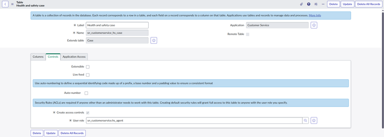

Step 1: Case type table
The case type table has the H&S agent role linked to it. This is not really important, but I think it is clean.

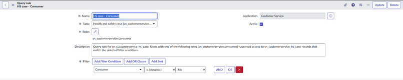

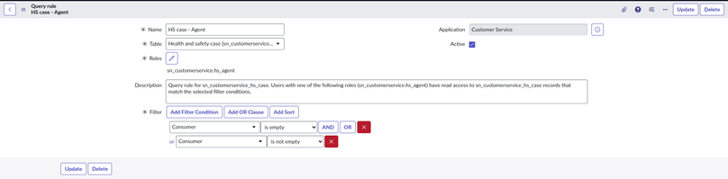

Step 2: Create query rules
Query rule for H&S agents (with condition that is always true as the field is required and the agents can read all cases):
Query rule for consumers:

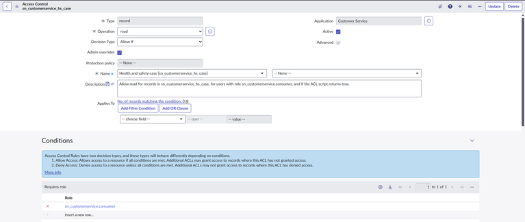

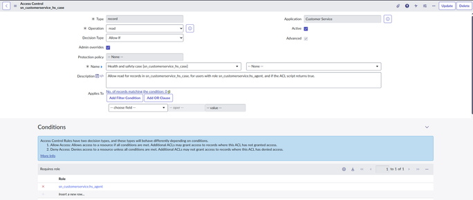

Step 3: Create table level read ACLs on case type which enforce query rules
ACL for H&S agents (with advanced script):
answer = false;
if(new global.CSMQueryRulesUtil().useQueryRules()) {
	var filter = new sn_queryrules.QueryRuleGenerator().getEncodedQuery("sn_customerservice_hs_case", "sn_customerservice.hs_agent");
	answer = GlideFilter.checkRecord(current,filter);
ACL for consumers (with advanced script):
answer = false;
	var filter = new sn_queryrules.QueryRuleGenerator().getEncodedQuery("sn_customerservice_hs_case", "sn_customerservice.consumer");
