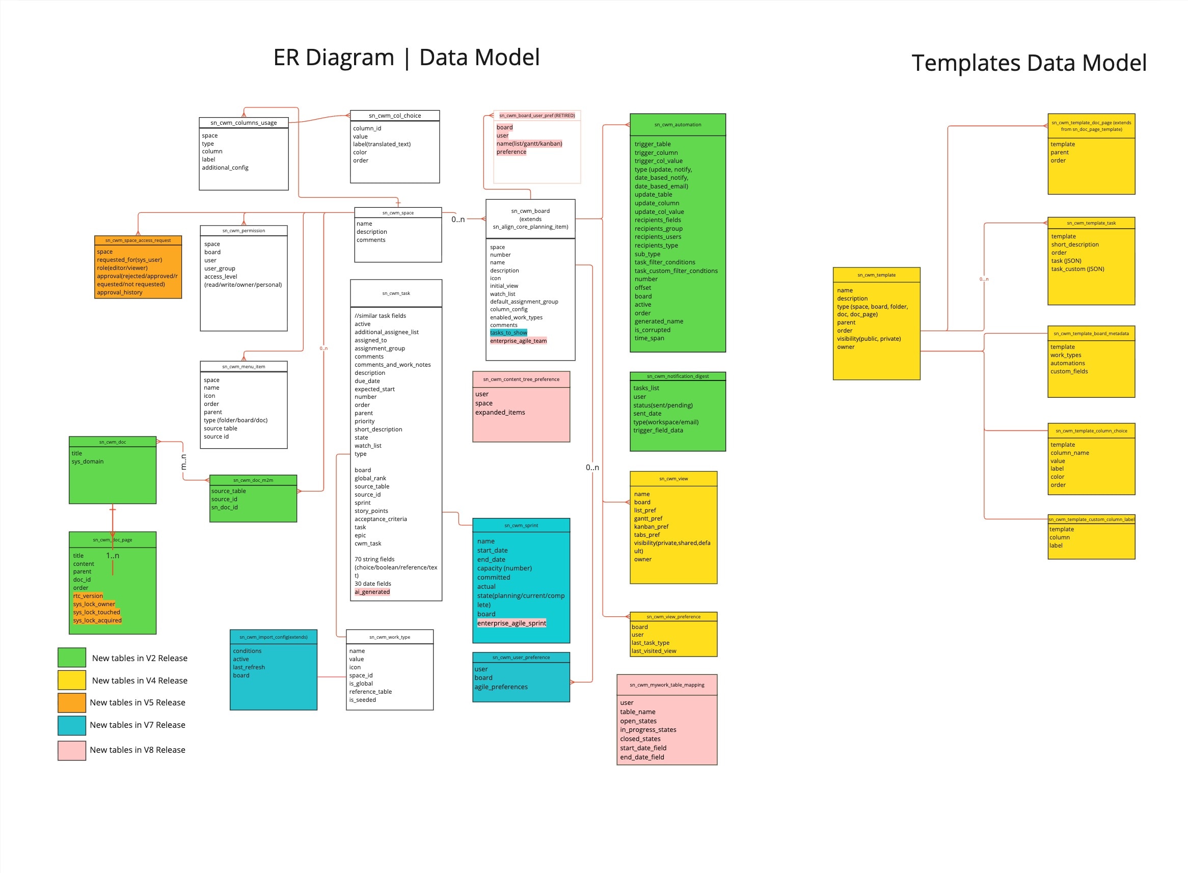

Is there some data model, that you could share which would show the connection between the different tables involved in the CWM process ?

b. Additionally, is the sn_cwm_task, with type=Story created for each rm_story record,  that is added or planned in the CWM? What is the connection between the rm_story and at the sn_cwm_task, type=story?
Yes, we create a rm_story record and create a shadow task to bind it the board through sn_cwm_task. We reference rm_stroy through task field on the sn_cwm_task.
Each CWM Board(sn_cwm_board) can have TASKs(sn_cwm_task). Each TASK(sn_cwm_task) can exist as stand alone or refer to existing task(or task extensions like story/incident/so on) record in ServiceNow.
c. If there is a need to build the report on stories,  the report be built on the sn_cwm_task or rm_stories?
Ideally it would depend upon the business use case. Everything potentially can be built on sn_cwm_task table for OOTB common fields. for other task types you can dot walk on task reference. We have plans to build OOTB reporting in 2026
d. Is there some data model, that you could share which would show the connection between the different tables involved in the CWM process ?
We have multiple tables, and the model may evolve as new features are introduced
I have attached the model for reference only.
