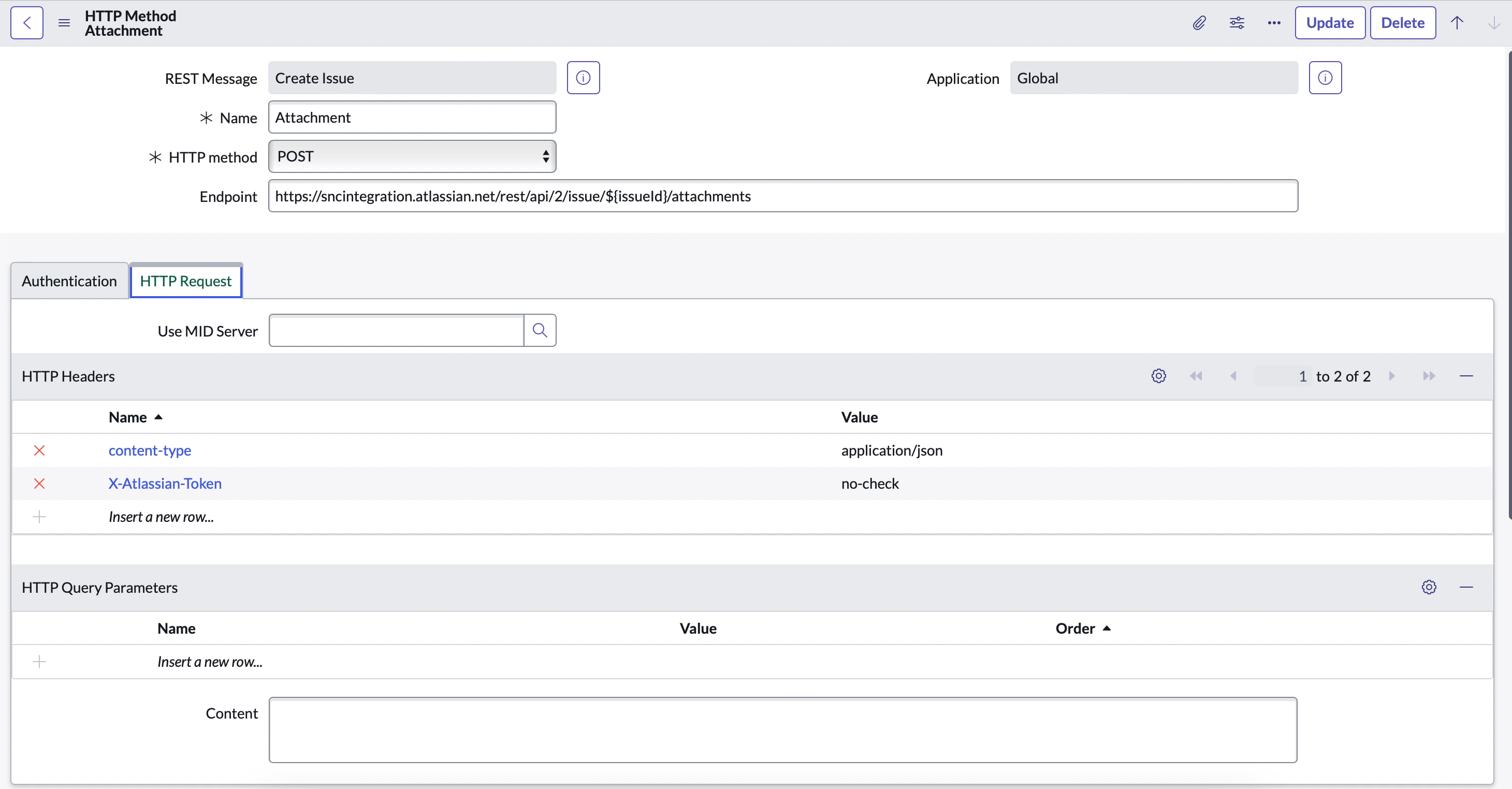

I am trying to send attachment from ServiceNow to JIRA through REST message, but I am getting 415 error, tried the same via postman as well and same error.
Attaching screenshot of the configuration that I have done for easier understanding. I have also added the code to build JSON object, although I can see all the details coming in properly in the LOG request that I am capturing.
Please help with this issue. Thanks.

Hi @Danish Bhairag2 , Thanks for reply, I tried the solution from the above post, but I am still getting 415 error. Please check the request body
## Log Request ## {"attachment":[{
"content_type":"image/png",
"file_name":"postman.png",
"size_bytes":"1124594",
"sys_id":"afcbf3e1474ab5104b5b9e79e16d4398",
"Content-Transfer-Encoding":"iVBORw0KGgoAAAANSUhEUgAACGgAAAX0CAYAAACfQ617AAAMP2lDQ1BJQ0MgUHJvZmlsZQAASImVVwdYU8kWnluSkEBCCV1K6E0QqQGkhNACSO82QhIglBgDQcWOL"

Since you mentioned the same error came from postman it means the way how request is sent along with body is not proper
Did you check JIRA documentation?
are you not using JIRA spoke for this?
check this link
How to send attachments from servicenow to jira
check this KB as well
Jira spoke - upload attachment from Jira to Service now
