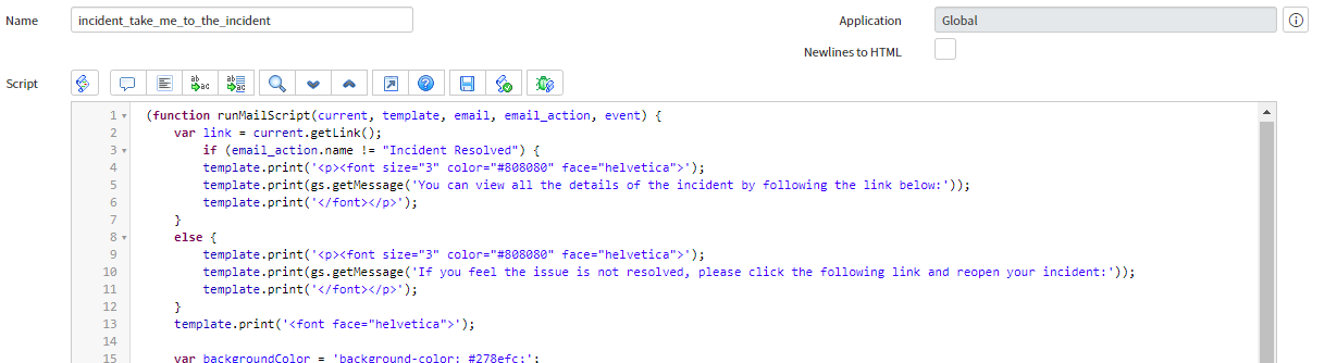

I believe email_action gives you access to the notification record (sysevent_email_action table). You should be able to dot-walk to the notification record that is being used for the email from there.
See oob email script called (lines 3 and 26): incident_take_me_to_the_incident for usage example.
