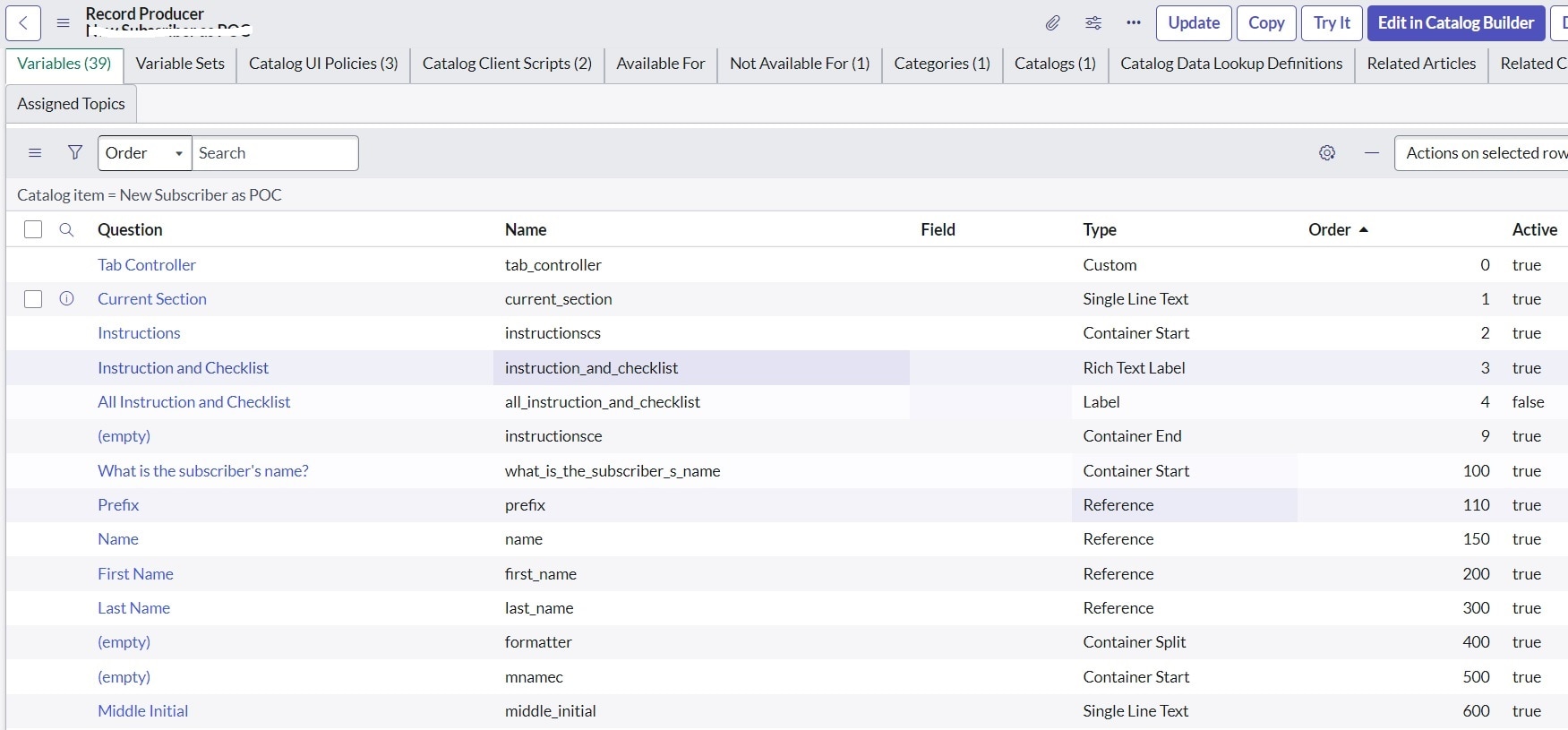

Do you mean indexes, the order of the variables? I have attached few screenshots of my setup, variables, Catalog UI policy, tabs. Please let me know what setup you need to see.

Thanks for the screenshots as it clears up what's going on with your setup. Your setup as far as sections is about the same as mine. Two sections. With two containers you should only have two tabs but you have six tabs.
The concept is that when clicking a tab it changes the current_section variable to hold the value of the selected tab. For example if I click tab 2, current_section's value should be 2.
For the UI Policy, any variable that I want visible when current_section equals 2 should be true and any variable that I don't want visible should be false.
If you want to stick with the UI Policy route with more tabs/sections you'll need more than two UI Policies to accommodate all the variations. Or a script can be used.
The basic concept is the tabs are use to set a value. Based on the value display the appropriate variables and hide the others.
