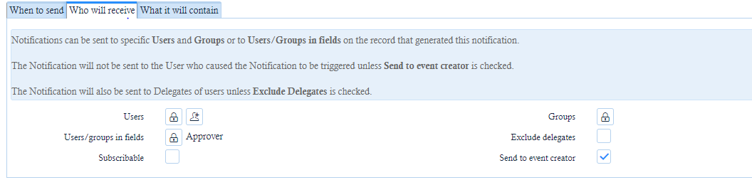

I am facing an issue with the email notification. The email notification for the approval table is not being triggered. The notification should be triggered for the manager of the current user.
These notifications are created as part of catalog.

Apologizes for the delay in responding back, I figured out the mail notification was working fine were in i had used "variable sets" which was the issue to fetch the manger name(approver) and trigger a notification, this variable set was inherited from another catalog, once i created a new variable with the reference to auto-populate manager name, I was able to send the notification.
