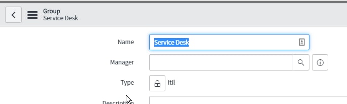

I followed the below wiki article, and assigned the group type as 'itil' and then modified the Assignment group's dictionary entry to contain type 'itil'

This works great, and as expected, until someone who is a member of more than one group.
What we have found is if you were to add an assignee in Assigned to before adding an assignment group, it will add the first group they are a member of, whether or not it is an assignment group with the 'itil' type or not.
