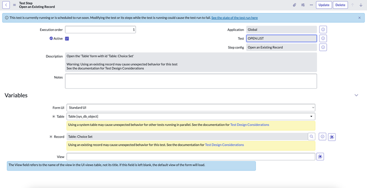

Yes We can Access .list of any table .
All servicenow table are present in Table module (sys_db_object ). following steps will show you how to access list view of any table . for this example i have taken example to open sys_choice_set.LIST .
- Open an Existing Record
- Click a UI Action
ATF Result Screenshot
Like this you can access list view of any table . if this answer is helpful for you please mark as correct .

09-04-2023 09:44 PM
Thanks for the solution Rangnath, this solution works for me!
