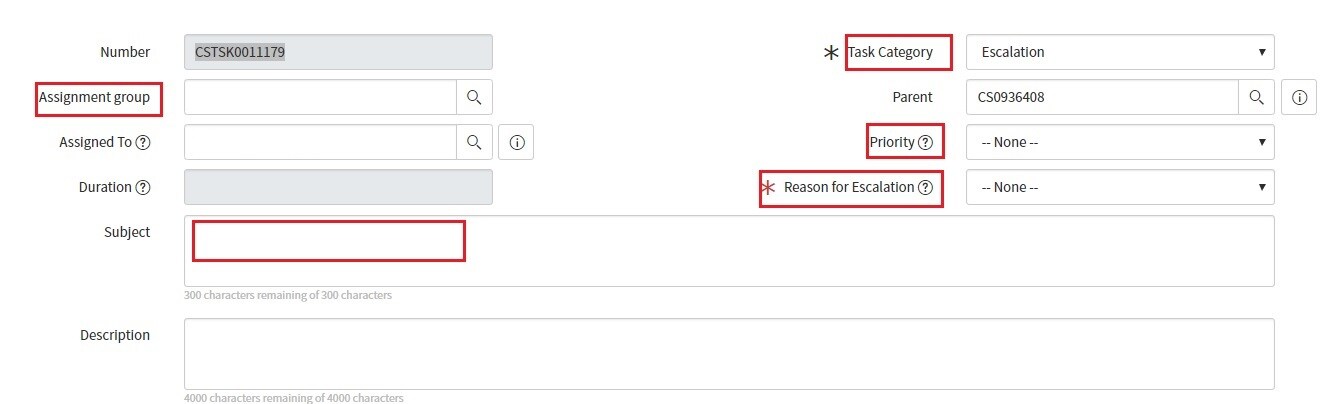

Also, I want some of the fields on the Case Task to be configured with specific values. How would I configure the script for that?
Additional Information:
This is what will be added to the Case, that I wish to to kick off the auto creation of a Case Task.
Task Category: Escalation
Priority: 2 - High
Reason for Escalation: Callback
Assignment Group: SMB Team
Assigned To: Empty/blank

I'm not experienced with scripting. How would I configure the script, to auto create the Case Task, and include the default choices I need (highlighted above).
You can do this through an "After" "Update" BR on your Case table with Conditions "Additional Comment changes"
Script would be something like-
var lastComments = current.comments.getJournalEntry(1);
if(lastComments.indexOf('The customer called and requested a callback') > -1){
var childTask = new GlideRecord('NameOfYourChildTaskTable');
childTask.initialize();
childTask.assignment_group = "ff0370019f22120047a2d126c42e702b"; //Add the sys_id of the assignment group
childTask.assigned_to = '6816f79cc0a8016401c5a33be04be441'; //Add the sys_id of the assigned to
childTask.priority = 2;
childTask.insert();
You can similarly assign values to the 'Reason for escalation' and 'Task Category' fields
