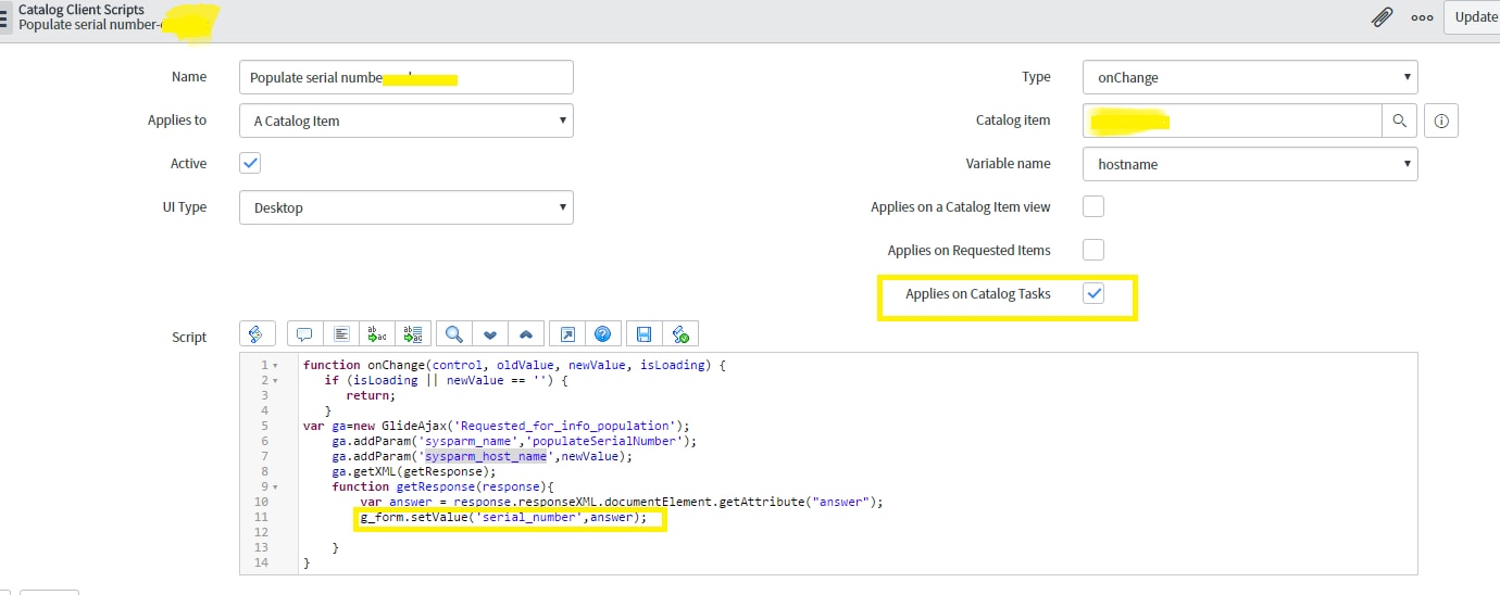

I'm auto populating the serial number based on hostname and which is working fine on catalog task level but when I save the catalog task form, I see blank value on serial number

Field readonly feature was causing the issue.
Resolved the issue by setting value first and setting readonly to true.

can you please share your script include code?
also make changes in client script. instead of giving newValue
try with
var check=g_form.getValue('hastname);
then pass "check" in ('sysparm_host_name',check)
in script include put the log while getting the sysparm_host_name.
