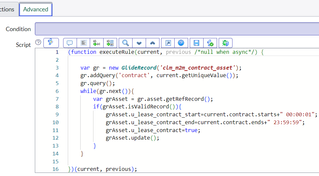

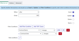

03-06-2024 08:42 PM
Hi @akin9
Since you're performing update related, your business rule above should be an After one, that runs on the clm_m2m_contract_asset table.
Ref: Prevent Recursive Business Rules
And to handle the date get changes on the contract table, you can have one more after rule that will query all asset covered and update it.
Sample.
After/Async insert/update
Conditions: Start date changes || End date changes
var gr = new GlideRecord('clm_m2m_contract_asset');
gr.addQuery('contract', current.getUniqueValue());
gr.query();
while(gr.next()){
var grAsset = gr.asset.getRefRecord();
if(grAsset.isValidRecord()){
grAsset.u_lease_contract_start=current.contract.starts+" 00:00:01";
grAsset.u_lease_contract_end=current.contract.ends+" 23:59:59";
grAsset.u_lease_contract=true;
grAsset.update();
})(current, previous);
Cheers,
Tai Vu
03-06-2024 09:56 PM
Hi @Tai Vu ,
Thanks for the quick reply!
Already My above script Before BR is running fine. that's also needed.
now contract extended and date is updated same need to populate on
related lists "Assets covered".
I have tried the script unfortunately not working. pls correct me if wrong
