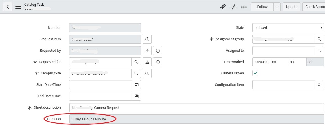

Ok so in the sc_task, I dot walked a "requested item" (there is no "parent" field in the form layout tool) and added "Duration" field to a catalog task.
One thing I noticed that the field was "read-only."  This could be a problem in some of our applications where the HR team has to set the values.
