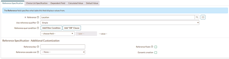

I updated the script as you suggested. Still seeing the same result. I also confirmed there is no reference qualifier on the OOTB location field.
