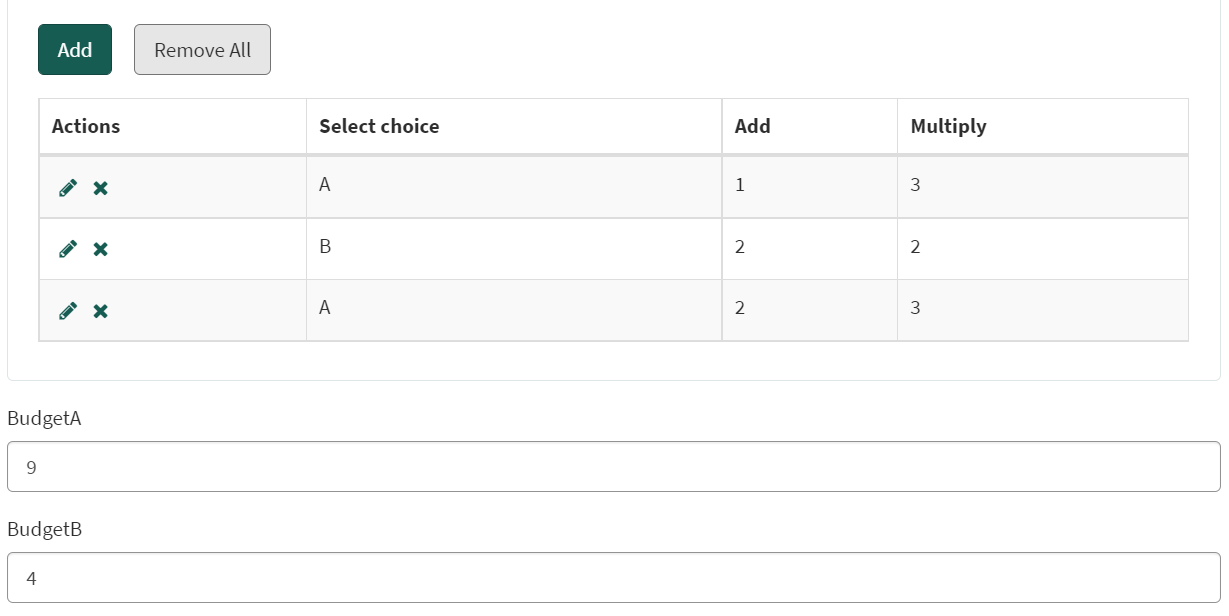

‎09-19-2022 07:12 AM
Hi
If you are using onsubmit it will be easy as suggested by Brad.
Sample script:
function onSubmit() {
var bA = 0;
var bB = 0;
var userDet = JSON.parse(g_form.getValue("user_details")); // mrvs internal name
for (var i = 0; i < userDet.length; i++) {
if (userDet[i].select_choice == "A") {
bA += parseInt(userDet[i].add) * parseInt(userDet[i].multiply);
if (userDet[i].select_choice == "B") {
bB += parseInt(userDet[i].add) * parseInt(userDet[i].multiply);
g_form.setValue("budgeta", bA);
g_form.setValue("budgetb", bB);
return false; //remove this line after testing..
Output:
Hope it helps.
Murthy
