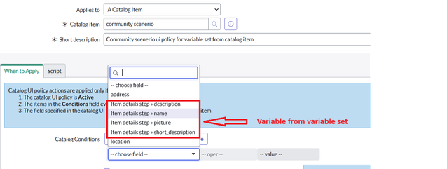

Yes, you can create a UI Policy on a catalog item to control variables from a variable set, as long as the variable set has been added to the catalog item.
Steps:
  • Create a new/existing UI policy on catalog item
  • In the condition builder select the desired variable set -> variable from variable set
  • Save and add UI policy action
  • Save and test
Example:
Here Item details step is the variable set attached to the catalog item.
Hope this helps!
