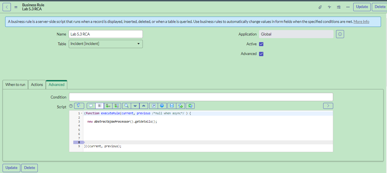

Hi Mohith,
Script include function:
getdetails: function() {
return gs.addInfoMessage(current.caller_id.email);
i accessed the "current" in script include as you suggested and it worked. But suppose we want to pass this to client script how to do this?

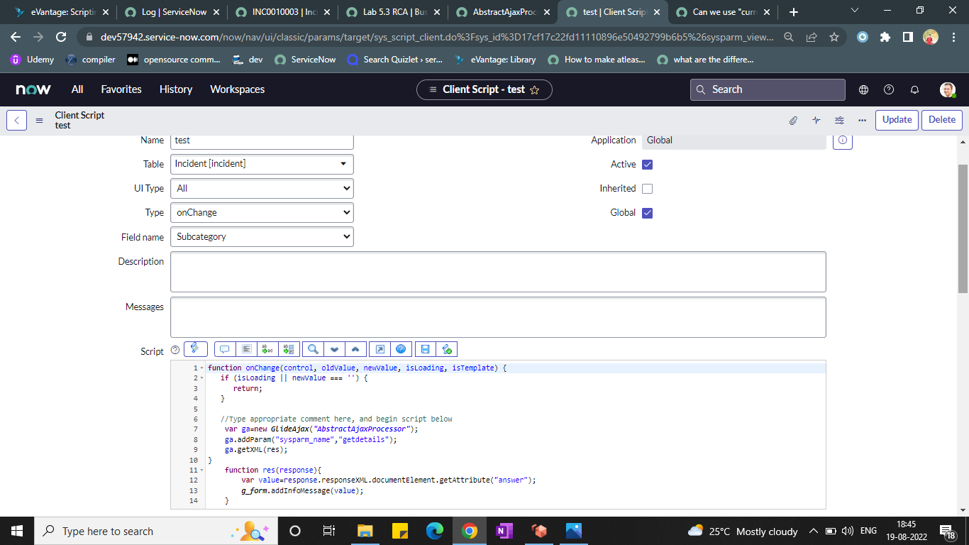

I tried access it in client script like below but didn't work:
Script Include:
return current.caller_id.email;
Client Script:
return;
var ga=new GlideAjax("AbstractAjaxProcessor");
ga.addParam("sysparm_name","getdetails");
ga.getXML(res);
function res(response){
var answer=response.responseXML.documentElement.getAttribute("answer");
g_form.addInfoMessage(answer);
08-19-2022 06:07 AM
Hello
Make sure our script include is client callable
and i noticed that there was typo error in "return" keyword so i corrected it .
it should work i guess now give a try with below scripts
script include :
return current.caller_id.email.toString();
return;
ga.getXML(res);
var value=response.responseXML.documentElement.getAttribute("answer");
g_form.addInfoMessage(value);
PLEASE MARK MY ANSWER CORRECT IF IT HELPS YOU
