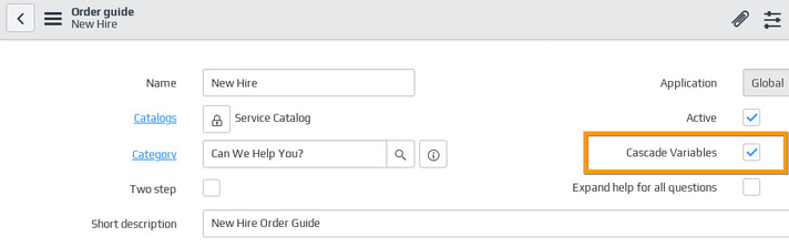

You got to use the below highlited option, this will pass the value from order guide to your catalogitem if the variable value matches in both order guide and catalog item.
