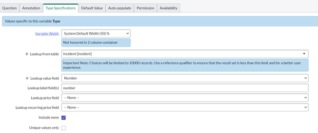

@Prajwal G Vaish you can take a lookup select box field type and do the configurations as below.
You can take any field their that you want to show in the reference field on catalog item.
Results will be like this : -

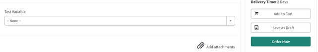

08-07-2024 11:23 PM
Hi @Prajwal G Vaish,
You will find "include none" checkbox in Type Specification tab of Variable
This will show value as --None-- in that field
Please mark my response as correct and helpful if it helped solved your question.
