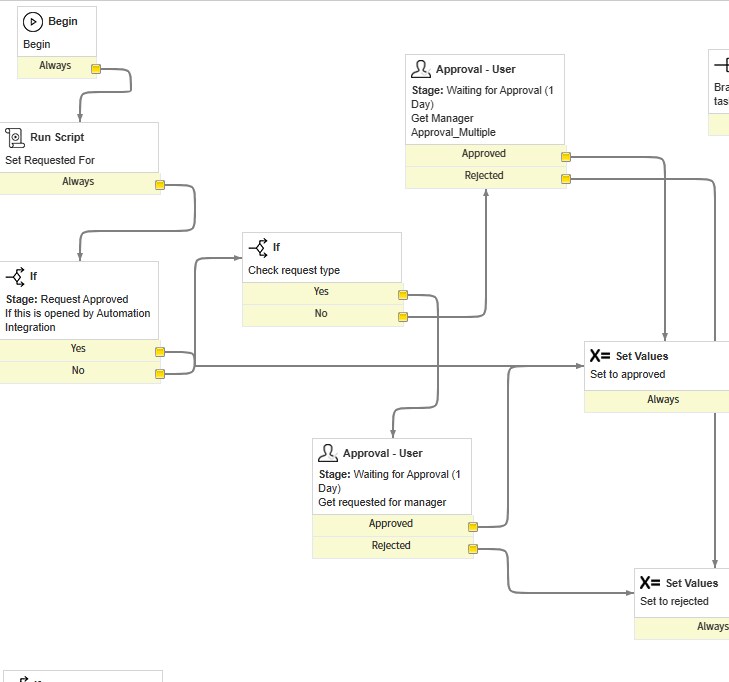

@Viraj Hudlikar Thanks for your response.
I didn’t implement any approval state before the "Request Approved" state in my flow, but I still see a "Waiting for Approval" stage appearing. I'm trying to figure out why this stage is showing up. I'll attach a snippet of the flow—let me know if you spot anything that might be causing this stage issue. When we raised the request i want the request state to be approved rather then showing as waiting for approval.
