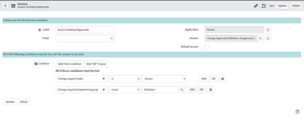

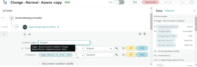

Hello Arangi,
In that case you have to modify the OOB Flow called "Change - Normal - Assess" and add and extra AND Condition(Record assignment Group is not "your choice of group") in the 4th Step if condition.
I have added a screenshot for your reference. However, it is not recommend generally to modify OOB Flows, so take caution. However, I have tested it in my PDI and it works as per your test case.
I hope this answer helps you. If you find this answer helpful please mark this answer as correct and helpful. Thank you.

Hello Arangi, did you also followed the first part. Setting the sys_decision_question table and search for label as "Assess Technical Approvals". Here you can add one AND condition in which you can specify the assignment group is not xyz.
You have to do both the changes the first part in the sys_decision_question and then the flow.
I hope this answer helps you. Thank you.

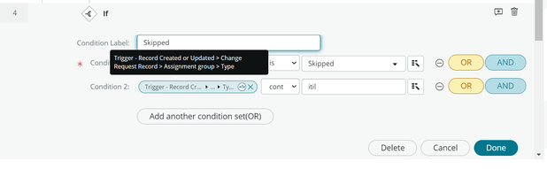

Hi @Taha Habib
It is working for only one assignment group, is it possible to set assignment group type because this functionality need to work for few groups, in flow designer I have added condition assignment group type is not 'XYZ' in place of assignment group name
But not working for group type

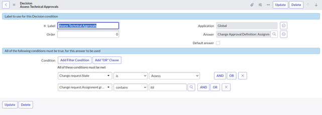

Hello Arangi,
Yes it is possible.
Update sys_decision_question as I did below and set the type to itil
2. Update flow as below
This works for all groups whose type is assignment in my PDI.
