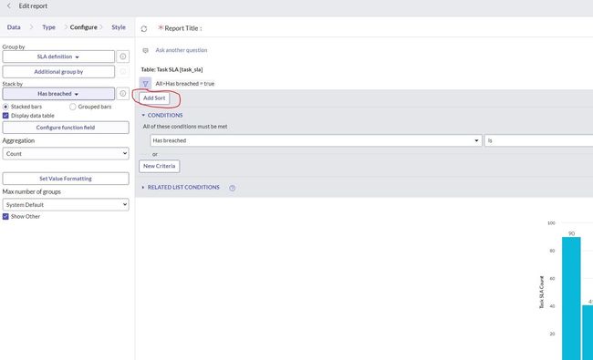

‎08-28-2023 01:12 AM - edited ‎08-28-2023 01:30 AM
Hi, I do see the Add Sort button in my Utah instane. I have seen where the button disappears in an already saved report. Might need to delete and re-add your filters in the report to see the Add Sort button.
