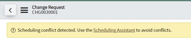

Hi all,
I recently upgraded to Madrid. On change records, I am getting a warning at the top saying 'Scheduling conflict detected. Use the Scheduling Assistant to avoid conflicts'. I see the onload client script for this message, its called 'Notify Conflicts' but it is not active. So how is this message still popping up if it is not active? Is it coming from somewhere else? Again, this is in Madrid.

This one was tricky but I manage to remove that message.
I was suspecting an Onload Client script or a display Business rule. It was neither of those.
To remove this:
Open a change request, Configure Form layout
Then Select the "Conflict Session" and on the right Remove the "Conflict Checker Progress" and save.
This will remove the message
