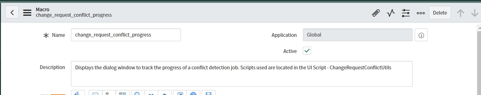

Hi All, had to struggle with the same. manage to find that this is in UI macro as below:
here you have line 83-85 that is responsible for the same. Commented out and the message will disapear and you will stillhave the Check Conflict button . No need to remove the whole button as suggested before.
