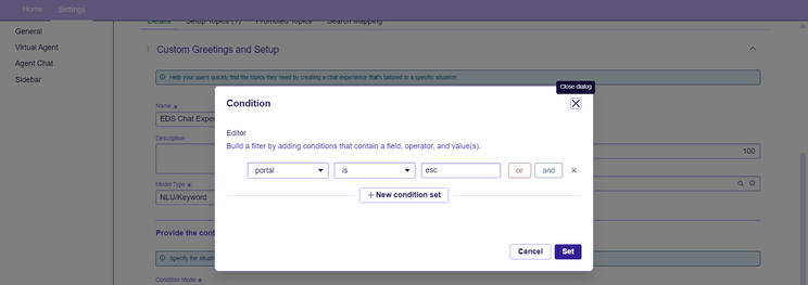

10-15-2024 04:48 AM
Refer below documentation for your requirement -
You can put a condition for specifying the portal as shown in the screenshot of the documentation.
