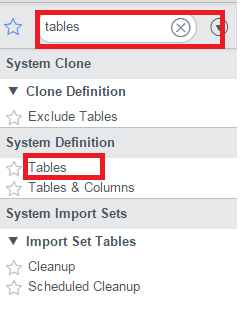

If you want to see the tables Incident or Task and there relationship
then just type table in service now navigator. System Definition>>Tables
then just search for incident table and see Extends table field, you can find Task
