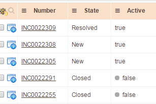

Thank for replying.   I understand that Incident in an extension of Task and that state originates on the Task table.   I don't understand why SN added incident_state to the Incident table if state was already available.
I also know that Active is a boolean field.   and that indicates that record is closed.   By the way the Active state is True when an incident is in the Resolved state:

I believe the idea was to be flexible back in time with SNOW. In past releases of ServiceNow, if a choice list was on task, then incident, problem, change, etc. all shared it (like they do any field on task). The limitation back then being that incident and problem couldn't have different choices for that field. If you wanted incidents to have an available state of "awaiting user info", it had to be added to all task tables, which didn't necessarily make sense for changes or problems. So the incident table got its own separate choice list field for its specific states (incident_state), and by default the task.state field was just not used for that table. Flash forward to today, and extended tables can have their own unique choices for a choice list field on the base table.
I think this is some legacy thing, which just needs to be cleaned up.
