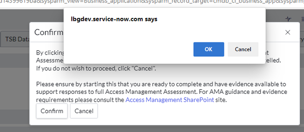

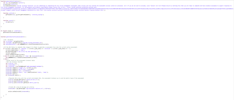

I've created the following code for my UI Action, which includes my GlideModal and a function:
When a user clicks the Confirm button, it should run the generateorContinueAssessment(). However, when I click the 'Confirm' button the following is happening:
I was just wondering if somebody could explain why this is happening and what I need to do to stop it.
In your code, you have an onclick=confirm() which is popping up the second confirm window.  If you name your function something else, like confirmAMA then make your onclick=confirmAMA() your code should work.
