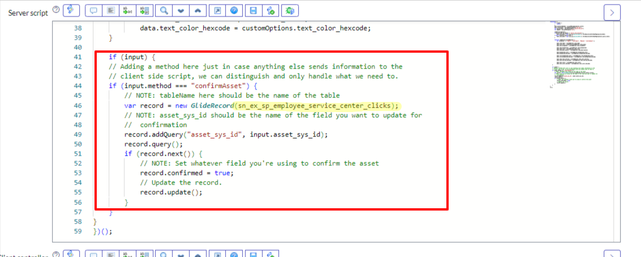

This to the server script:

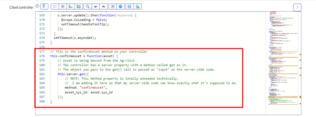

This to the client controller:

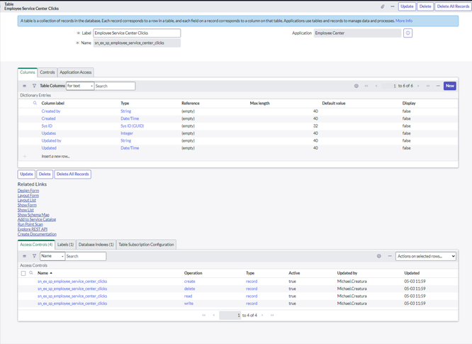

As you can see in the Server Script, I have created a new table and referenced it where required, but do I need to add anything else too it?

@MichaelCreatura , where are you storing the clicks in your table
  1. Create a new field called count
  2. when you gliderecord your custom table add the count to your count field
gr.count +=1
gr.update();
Let me know if you need anything
