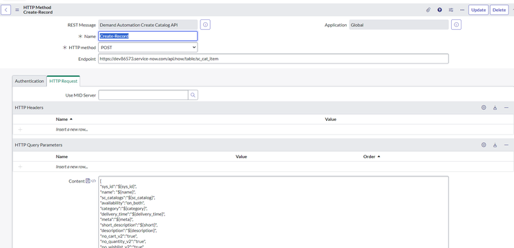

Ravi Gaurav
Hi @Pawan Kumar Rai
You need to use the concept of table API. Use that in rest Message like the below image shown and then create a JSON body to first create a catalog like below

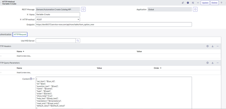

Now you create another Rest Messgae this time to create the variable for the above catalog  like the below.
Pass the sys_id of catalog in second image.
If you want to automate use Business Rule.
