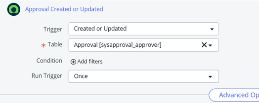

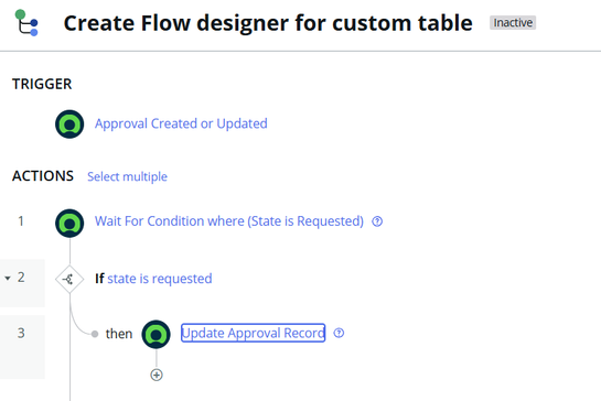

Hello @Zuri
  • To demonstrate the flow, I have considered sysapproval_approver table.
  • You can modify this for your custom table.
Follow these steps to meet your requirement:
Flow structure:
Trigger:
Step1:
Step2:
Step3:
  • Update the enable timeout duration as per your need.
  • This will wait for 7 days and if the approval state is still requested, it will be updated to rejected.
  • You can modify the conditions and table as per your requirement and configuration in your instance.
Hope this helps!
