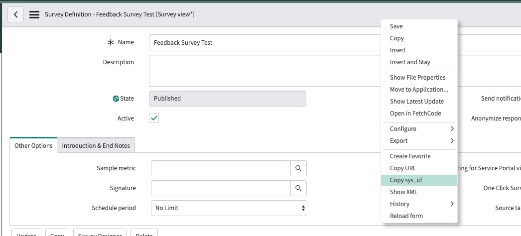

First, go to your Survey Definition, we'll need the Sys Id of that record. Right-click on the header and select "Copy sys_id"
Then on your "Feedback" button, set the URL to this, replacing the portions in [BRACKETS] with your values:
https://[INSTANCENAME].service-now.com/[PORTAL]?id=take_survey&type_id=[SYS ID OF SURVEY WE COPIED]
