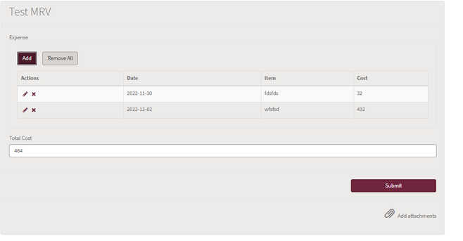

i am task to create an expense request form in ServiceNow and have decided to use the MRV for the expense line items.
But one of the requirements is to get the total item cost listed on the form as they are entered into the MRV.
What is the best approach for this?

IF you want to do it on change of the MVRS then i can suggest you a solution which i used in my requirement and it worked for me .But its bit a lengthy process but we can do .
Follow this process step by step :
1)You need to handle this via hidden widgets on the record producer
create a widget with this code

2)After this create a Variable of type Custom and add the Widget  in the widget field like below
Hope this helps

This is Totallly Amazing, 2 years trying to figure this out and it work
Nope the users will only need to do this in the Portal and not Native
Thank you, Thank you, Thank Youuuuu
one thing i noticed, it doesnt handle decimals
when i type in 43.50, it will round to 43
i tried parseInt(total).toFixed(2) and also what you see above and it didnt work
By definition, parseInt is going to grab an integer from a value.  If you're introducing the possibility of decimals, then use parseFloat instead which will grab the number, with any decimals, no rounding unless you add .toFixed(2)
