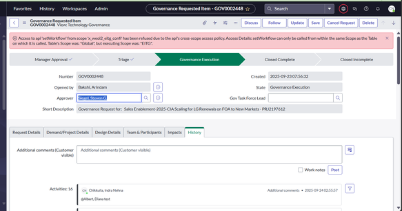

We are facing a cross-scope access error when using @mention in Work Notes or Additional Comments on tables that are created in a custom application scope (EITG) and extend from the Task table (Global scope).
Error message:
Access to API 'setWorkflow' from scope 'x_weoi2_eitg_conf' has been refused due to the API's cross-scope access policy.
Access Details: setWorkflow can only be called from within the same Scope as the Table on which it is called.
Table's Scope was: "Global", but executing Scope was: "EITG".

09-23-2025 05:00 AM
screenshot cannot be seen clearly.
09-23-2025 11:58 PM
Hi @Ankur Bawiskar ,
Please find the above screenshot..
Thank you
