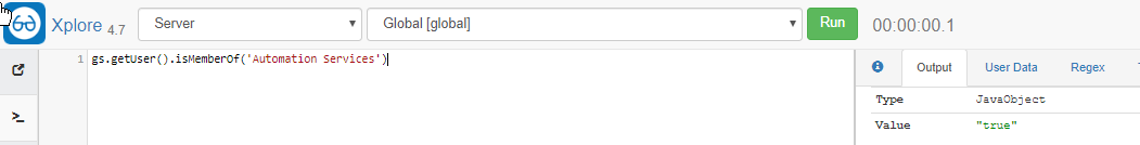

Verified using Xplore in Madrid:
Global isMemberOf()
Scoped isMemberOf()
The only differences are that in scope isMemberOf() returns a boolean, but in global it returns a string.
