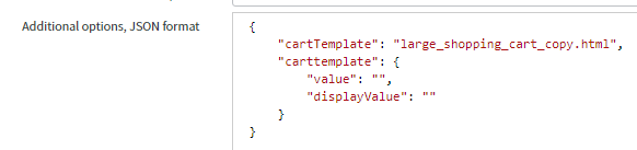

It doesn't seem to matter which template I select for the Shopping Cart--it always displays the same result. Even if I create a blank template or one with just a single <div>, it still displays the default cart and ignore the template I select in the widget options...
I had the same issue, I could never get the widget option in the SP designer to work and ended up opening the record in the platform and updating the additional options there...   Do you have the widget instance pointing at the template and the template pointing at the widget?
Widget instance pointing at your template:
Template pointing at your widget:
