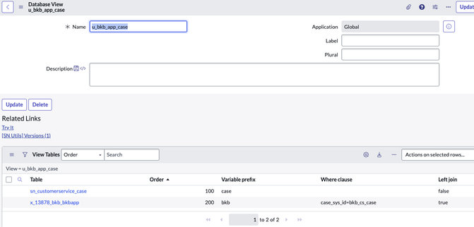

I have this setup
I want the case table to show all the records inside of it - Please note that I already have the 'left join' as true ...
How can I achieve it - If it is possible

Change the Order on case to 200, move the Where clause to the case table, and switch it so that case is to the left of the =, then the left join will show all records on the case table, even if there is not a related record on the other table.
Hi Brad,
Thanks for the help so far, this is what I've tried
Result: Its showing all the records on the time entries table but not all the cases (not even 1 case is coming)
Just FYI - the Case table has a (1-n) Relationship with Time Entries / Time entries tables has a (1-1) relationship to Case table
This is the correct use of left join.  Your issue with this view is likely that it is in a scope, uses a custom table in a scoped app, and/or the table in the Customer Service app.  Make sure your table/app has cross scope access, and try creating the view in the Global scope.
Yep , unfortunately no success ...
I thought Database view could do that...
Its showing ALL the time entries and NO case - Both apps have Cross Scoped Privs (Read) to each other
