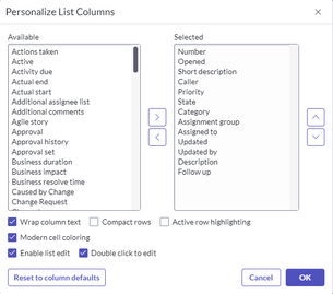

6. If a user still wants the flexibility to customize their views, they can still change their list via the "Personalize List Columns" button. This will not impact the default list layout that the admin made.
If they afterwards want to revert back to the default list layout made by the admin, they can always select the button "Reset to column defaults" within the personalize list menu.
