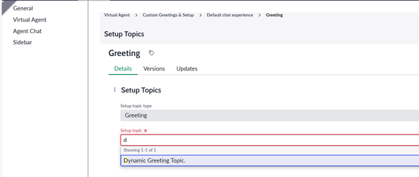

I wanted to add the Dynamic Greeting Topic to my VA but I can't find it in VA Designer.
I installed "ITSM Virtual Agent Conversations" and I'm using the Xanadu version.
Can someone tell me whre is the topic ? Do I need to install more module ?

Hi @Dr Atul - LNG ,
As you can see in my previous anwers, I don't have the "Dynamic Greeting Topic."... That's the whole point of this discussion.
In your first answer you told me "believe me it is not easy" and I believe you, I can't find any help on why this topic is not existing on my instance.

Hi @Dr Atul - LNG,
I repaired the plugins but I still don't have access to the topic.
I found under "Virtual Agent Designer > Explore additional topics" that I need a spoke/plugin to have the Dynamic greeting topic:
I wanted to try the link "View" to see if it helps me but the link is dead..
