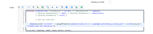

@vidhya_mouli ,
You can create a email script and call this email script from Notification and in the email script, Please use below code:
template.print('<a href="' + gs.getProperty('glide.servlet.uri') + 'u_manager_activities_sv.do?sys_id=' + current.sys_id + '">Please open the record</a>')
Please refer the image for more info:
And call this using below method in notification:
Incident Number: ${mail_script:NAME_OF_YOUR_SCRIPT}
