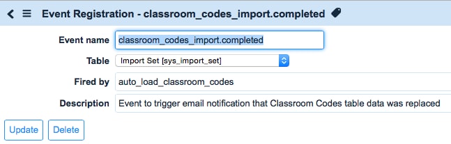

Thank you everyone! I understand the concept now. I just tried this and I did not receive an email. Below are my steps. Let me know if you see an obvious newbie mistake!
1. Table Transform Map: Auto Classroom Code load - onComplete script added:
2. Event set to Table Import Set:
3. Notification changed to trigger from event rather than updated records:
I assume the Table selected here should not matter?
Currently the email is just being sent to me. But will eventually add a group once I get it working right.
I then executed my import, which should have completed and triggered the event, which should have sent an email. I checked the event log and I do see that my event classroom_codes_import_completed ran successfully (correct time stamp).
Check email and email logs - no email.
So, I'm still stuck but almost there! Any ideas?
Hello Cathy,
It seems that you are on the right track, The table in the notification does matter but you have it right, it has to be the same as in the event.
I think the problem is that the only recipient of the email is you, I have had this issue in the past, for some reason emails were not sent to me. Could you please add another user in the recipients list? just to see if you are having the same issue.
Thanks again for your reply!
Added a second user in notification, executed import, checked that the event was successful in event log, waited a few minutes, checked email logs for a while, still no email for myself or other user.
