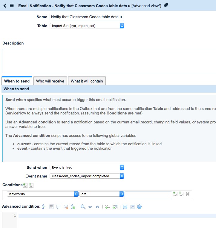

No condition set in the email notification:
Hi Cathy,
Yes the event is working fine. That Keywords are condition confuses me, can you please remove it? just to make sure that it is not causing problems.
I'm not sure if it matter but... do you have enabled mail sending in your instance?
In the process of removing the condition as you suggested, I saw the actual problem. I had renamed my event earlier, and I did not update the event name in the post script on import (see pic below). Once I named this event in the import script correctly, the email was generated! Excellent!!!
