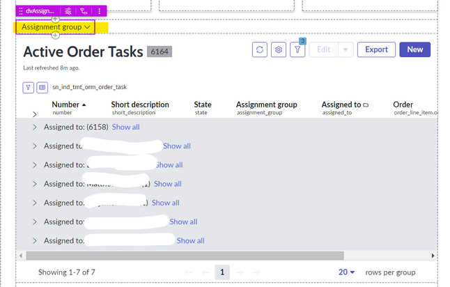

I created an assignment group filter in a landing page in CSM/FSM workspace
This filter is supposed to Filter the List report (Data Visualization) below. But its still not filtering? Am I missing anything?

It turns out , it is filtering single scores, but not the List Data Visualization I created.
My main goal is to filter the List report

I found the solution for this using these links:
1. https://www.servicenow.com/community/developer-blog/set-up-interactive-filter-on-ui-builder-for-d...
2. Another link I cant find - Using Client state in a reference field
STEPS
1. added a dropdown button
2. Added list of choices - I hardcoded them, but I'm pretty sure you can script them as well
3. Created a Client State parameter for Assignment group
Defaulted it to the one of the assignment group choices
4. Updated Fixed filter on the List Data Visualization
