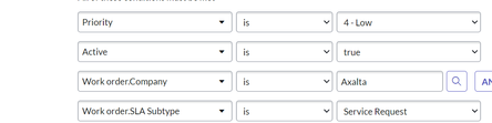

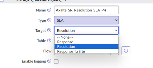

these are sla configurations and i have catalog form in form i have field it is reference to sla table here i need to filter the based on company and Type of SLA and shown in Assocaiated SLA filed
 tried with dynamic reference qualifier
javascript:'company='+current.variables.company;
but not working any one help me with this. how can i achive
