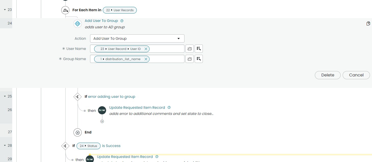

I have a for each loop to add users to AD group, and that works fine.
However, I need to add logic to the flow, so the request is closed if users are added to ad group successfully.
It does not have to be all the users from list collector, but as long as some are added I want the request to be closed complete.
Now if i add the if logic to check if status was success within the for each loop then it will change the state of the request for each user it adds?
see my flow below, where I have moved the if step and update record step out of the for each loop...
, but here also it does not work. as the runtime value does not equate to success, but equates to {0}??? im not sure why this is, maybe because I am checking outside the for each loop?
ccan someone provide a suitable solution here please?

what is that step 24 which will give you Success
Can you share that test step image

I believe you cannot access output of step 24 outside for each as it's context is within for each only
Possibly you will have to use some flag to hold the value when success set it with true
then check for this flag outside for each

Starting in Quebec a scratchpad has been implemented for flows in the flow designer. You should be able to use that to carry the value to step 24.
See documentation on flow variables here for details.
