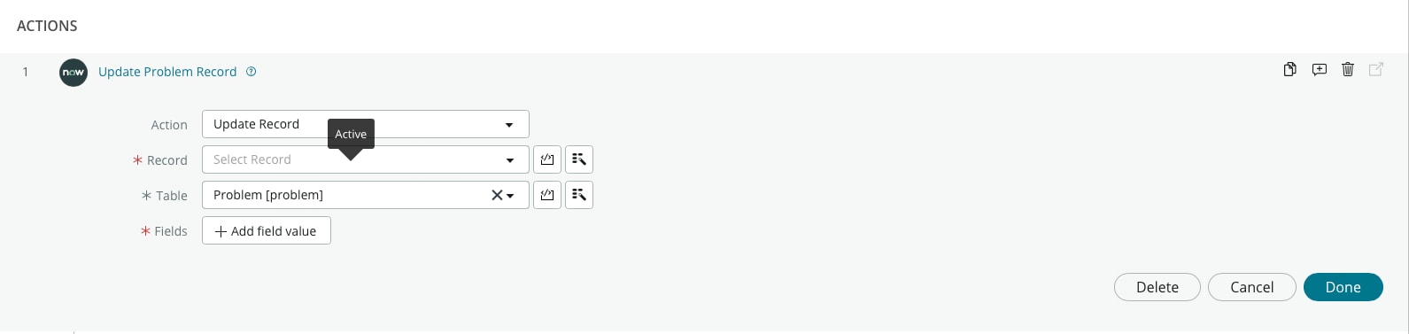

These are my actions:
For the Record I have Trigger - Record Created or Updated➛Change Request Record➛Parent➛Number.  Which looking at that field in the table is the correct PRB reference to look it up in the Problem table.  If I try to go with just Parent and not Number it forces me to use the Task table.  No idea why that is.

The parent field on the Change Request table is a reference to the Task table, that's why it forces you to select from that table.
If you want to access the Problem table directly you can do a work around with a look up record first.
Something like this:

You should stop at 'Trigger - Record Created or Updated➛Change Request Record➛Parent'. Number is a string field and Parent is the Glide Record.
Thank you Kristy - the only problem I have is when I do that is changes the table to the Task table.  If I then revert to Problem, it clears out the Record Field like so...

Thank you!  Worked perfectly 🙂
